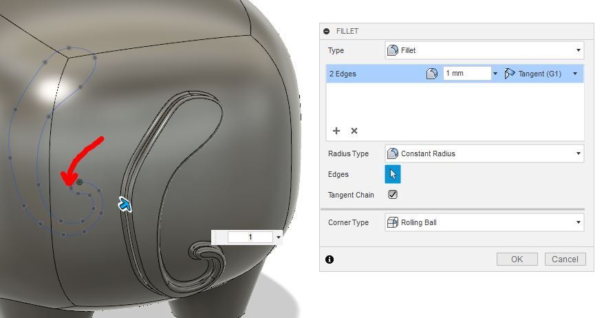

Is there any reason why I cannot fillet the tail?

The tail won't fillet beyond the size that results in the fillet touching itself. Here you can see that I've adjusted the Sketch for the tail and made the indicated bit a little bigger/rounder.

oh cool, great. so it was the sketch being too close to each other.  makes sense and not sure why I didnt think of that.
