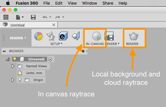

i saw lot of posts about raytracing renderer in F360. but i cannot find my ENABLE RAY TRACING button beside the capture image. all i see is in canvas render
this issue happens in both my laptop ( mac ) and my garage computer ( Win )
i include the screenshot.
well, im a student and using student license is it have something to do with licensing ?

Hi @Anonymous,
There are 2 local and one cloud based ray tracers in Fusion.  The In Canvas render is an in session ray tracer that renders in real time in the session.
The Render icon will take you to a dialog box that will enable you to either do a background ray traced render of the image on your machine or send the render job to the cloud.
Hope that helps.

tHANKS, so actually i had raytrace all along.
if you click on set up and enable depth of field it says this will only be enabled when ray tracing is activated.
So where is ray tracing? that is the big question I would have expected to see a setting like in other AD programs
