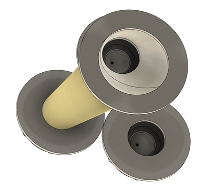

joni_lundberg
Another problem appeared.
When using multiple interconnecting lofts, they cannot be used to split each other, leaving not a cavity, but instead an overlapped lid where there should have been a hole. It would have been so easy to use split body tool using the yellow lofts below, but I am not allowed.
Message 10 of 133
davebYYPCU
No file, and not the bent version?
Because you have used Surface Loft, you can use the Surface > Modify > Trim tool, over and over, if the picture shows the problem properly.

Message 11 of 133
joni_lundberg
I tried to delete the yellow Lofts, and using the same start and end circle as before, but now the Loft tool is not working. It only works on new cylinder bodies. So I am stuck with the old yellow lofts that I chose.
Message 12 of 133
joni_lundberg
Trim tool got me this far, but now the two remaining yellow lofts want to delete each other with the  Surface > Modify > Trim tool.
Message 13 of 133
davebYYPCU
Set the view to be looking up from small end.
Select the tube you are looking through. Turns blueish.  Then select inside the walls to cut, 2 to cut have to select both sides
3 tunnels, 3 trim cuts, works as expected.
Might help....

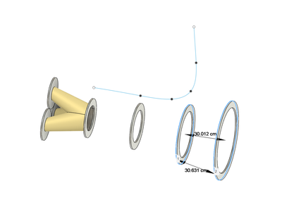

Message 14 of 133
joni_lundberg
Thanks! Tricky, but I succeeded with the trimming.
I have made some 1 cm thick cylinders to find the shape of my cone. The goal is to coat the inside and outside using Loft.
When I curve my cone, is there a way to keep the distance (for example 30.012cm in the image below) between the center of the cylinders the same as before, even when I twist and turn in my cone? It would be nice to anchor them to my sketch line.
Also, as you can see my sketch line is not even close to the center of the cylinders.
Message 15 of 133

Message 19 of 133
joni_lundberg
Thank you for the help. I want to split my loft like sliced bread with 15mm slices, in order to saw it out by hand, or send it to CNC in many 2D files. But it is not allowing me to split it.
I just uploaded the file, and it it is editable. I can't even select the model. The splitting tool (a rectangular box) I can select fine.
Solution: Export it as a Step-file, upload it again, and start splitting per instruction. Your own format does not allow splitting lofts, for some reason.
Message 20 of 133
