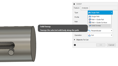

I am designing this bolt action pen, and when I make this pen I will cut out the slot for the bolt on a mill with a rotary table, so the slot wont cut straight down, it will cut down with the profile of the 'body end' piece.

Solid Sweep (with Cut)

I am having trouble with the solid sweep feature because I have never used it before, and for the threads I do not know how to align them.

You have been given the best method of cutting the pen slot but you probably are wondering how to get the Solid Sweep path.  In my attached video I outline one method.  I hope it helps.  The model I used in not yours just one I created to demonstrate.  It is attached.

thank you this will help a lot
