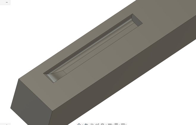

I need help making a transition for this region of my part:

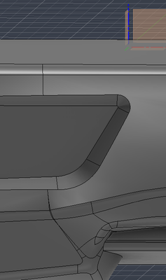

It currently has a step transition but i want it to be more of a gradient transition like this:

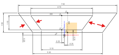

These images are from a practice model that I have been playing with before I implement this feature on the main model.
The dilemma is that I want keep the angle that is on the right of the feature in the first image, but have it transition as more of a gradient rather than a step. Kind of a  mixture of the two. The feature on the first  image was created using the extrusions (cut) tool at an angle.

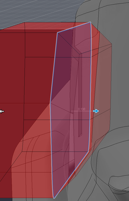

The second image was created using a surface modeling method. I've  attached a .f3d file of the practice model  to this post. The main model, from the first image, can be transitioned from a solid model back into a surface model, so I am not worried about that. I need help figuring out a workflow/method utilizing surface modeling to achieving this. I hope this make sense, feel free to ask if you need clarification on what i am looking for,

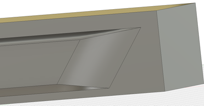

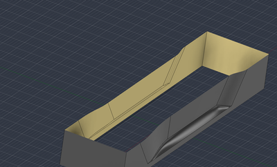

After some playing  around and adjusting the work-flow, I was able to get the results I wanted. It was a matter of playing around with boundary conditions  in the loft and patch commands while in the surface workspace.  Here is what i was looking for:
The first image below has a gradient transition that starts at an angle and end at an angle. The second  image below has the gradient that starts vertically and terminates at an angle.

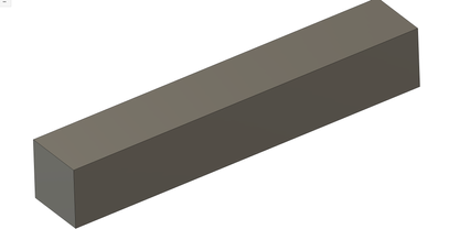

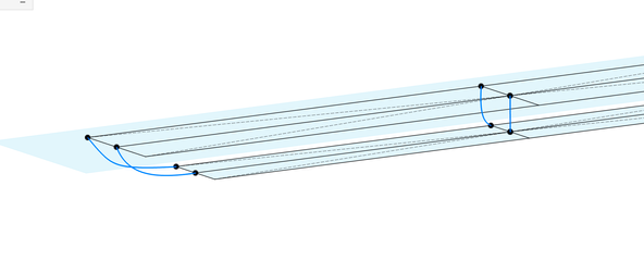

I'll share what I did in that model.  Some of it will be applicable to your model, some will not.  The short answer is:  rail curves.  This gets you the most control over the transitions.  Here is the thought process I went through.
  1.  created a block, centered on the origin:

  3. then, added a 3D sketch and started to define spline curves by using "Include 3D Geometry" to get the points from the two sketches into the 3D sketch, and 3D Splines for the curves.  You can use Move to tweak the handles (I can demonstrate if you are not familiar with this).  It was at this point that I realized I should have just modeled 1/4 of it, since in this test model, everything is  symmetric.  This let me create 1/4 as many rail curves.  I created this 3D sketch.  The selected curves are all that are in the 3D sketch:
    here they are in isolation:

You won't be able to use Mirror, since your desired shape is not symmetric, which probably means you will need more rail curves.  But, once it is all set up, then just editing those rails using 3D Move allows you to tweak the shape nicely.
Model is attached
