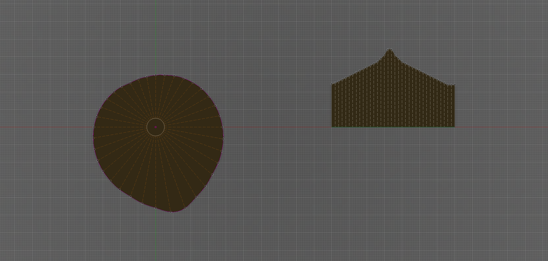

Here is a brief example of a mechanical cam (like the kind found in your car engine) driven by the parameters table with user parameters. The table drives the lines in the rectangular array of lines (like a bar chart), which in turn drive the cam wheel spoke lengths. I couldn't figure out how to dimension the spokes directly, because Fusion kept referencing the horizontal or vertical, rather than the simple length of the spokes. Is there a toggle for that?
Also, I used splines to connect the outer contour for both the cam and the top horizontal line in it's rectangular equivalent. I wonder what kind of curve is best there. (Splines ring with large excursions, straight lines leave flats, and I did not try conic curves yet. Seems like none of the choices are mathematically right, unless there is some stunt to smooth them more like a low pass filter to avoid large jumps and ringing. Maybe just pre-filter the parameters. I also noticed an add in to export and import parameters, which makes saving parameters easier, so you don't have to type so much.

When dimensioning the spokes, with the dimension shown interactively, right click and select "Aligned". This dimension will then be the true length and not be constrined to X or y direction.
You can adjust the spline handles to avoid the "ringing". It might also possible that a CV spline is better suited to do this.
If you attach a file (in your own thread, please 😉 I can try it out and show how that works.
