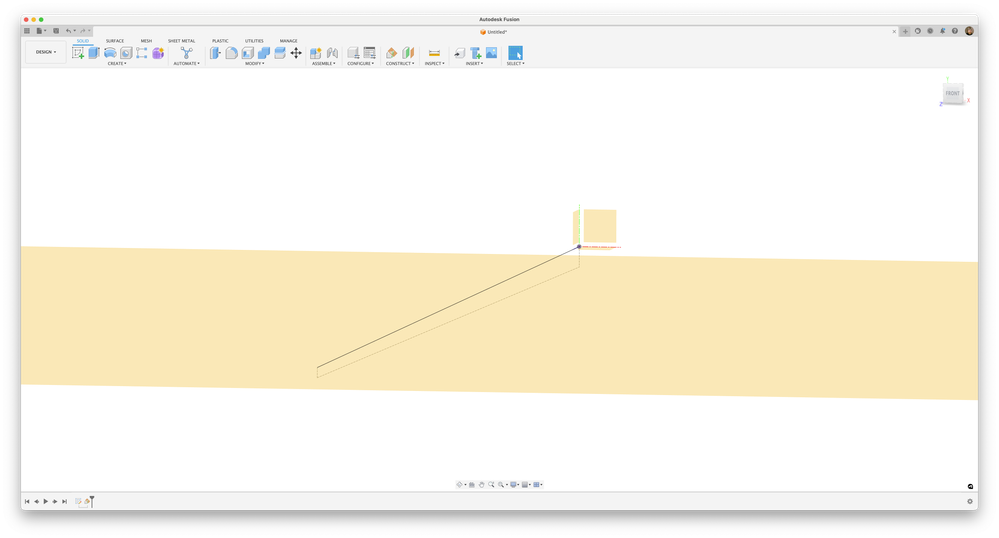

I don't make guitars either. Someday I'd like to!
Although I appreciate your replies, I think you misunderstood what I'm asking. I am definitely not asking for modeling or workflow help.
It's possible that I did not include enough information to present what I am actually asking here, but it boils down to "what is a guitar?" Just like in basic training (I still can't believe that was 22 years ago!), when I had to answer "what is an M16?": "Drill sergeant, the M16 is a 5.56mm, magazine fed, gas operated, air-cooled, semiautomatic or three-round burst, hand-held, shoulder-fired weapon!" My guitar has six strings, a 24-inch scale length (Fender Jaguar) and it looks cool. But to define it in CAD, I have to pick a point that everything else is defined from. It's not arbitrary!
I have never made a guitar, and I want to know some technical definitions before I attempt it.

And that rock-solid point is exactly what I am looking for. I have attached a deliberately silly screenshot of a cross-section of the relevant geometry, which is a slice through the center of the neck.
Message 8 of 45
@Fully_Defined wrote:
I have attached a deliberately silly screenshot ....
I am out. I deal with in logic.
Good luck on your design endeavors.

Seriously?
The whole point of showing an irregular quadrilateral is because it is an irregular quadrilateral. I have simply exaggerated the shape for the sake of illustration.
I probably could have chosen better words, but it's not that serious. I notice that it looks suspiciously like it's in perspective, but really it's supposed to be as if I sawed through the fretboard.
Message 10 of 45

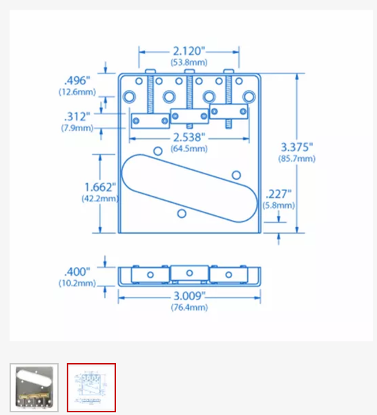

Some detail is available on the net. Stewmac provided this drawing for a traditional tele "Ashtray Bridge".
There are a few of these type of things available. I usually get a drawing like the above and make my own model in
Fusion.

As a possibly better illustration in context, in the screenshot below, I have placed a sketch in the YZ plane, which could be considered a slice through the neck centerline. The sketch line is representing a 24" string, and the construction line and plane represent the top of the fingerboard. Perpendicular from both ends of the string line are construction lines that represent the height of the nut and the height of the saddle, as offsets from the string line. Arbitrarily, one is 4mm and the other is 8mm, but they could be anything.
This is only one of several scenarios and considerations. The datum could be on the twelfth fret, or the nut or even the junction between the nut and the fingerboard. In any case, the offset lines described above could (and maybe should?) be perpendicular to the fingerboard instead of the virtual center string.
The reason any of this matters is because I want to design the guitar without considering cosmetics at all, as a parametric object, whose aesthetic does not affect how it works. How it looks is literally the last thing on my mind at this stage of design. Manufacturability is also important, and I have a CNC router I special ordered from Avid that has just enough of a work envelope for any conceivable guitar component. It's a wide-shallow "Benchtop Pro" machine, which is not officially in their catalog. It lives in my apartment in San Francisco, which is nuts.
I might be totally wrong about my assumptions about guitar string fixture geometry. I might be defining a guitar wrong. I'm here to learn from those who know.
