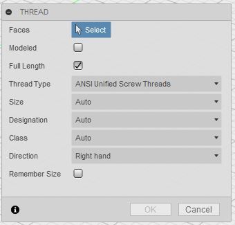

I would like to model both male and female garden hose threads in Fusion 360.  Does anyone know what specs to use in the Thread dialogue box?
Many thanks - Jerry

Hi etfrench,
Thank you so much for your reply.  I have seen that post previously and understand the specs; however, cannot find settings in Fusion 360 > Create > Thread (see image attached) that will reproduce these specs, i.e., what is the Tread Type, Size, Designation, Class that will give me the result required.
I am new to Fusion so perhaps I am niave in thinking that this is how I would create a garden hose thread.
Any further thoughts you might have would be greatly appreciated.
Cheers,
Jerry

This Fusion Quick Tip video shows how to do custom threads.
ETFrench
Message 5 of 20
jevans3XST6
Very helpful video.  I believe it will help me achieve the result I'm looking for.  Thanks so much for taking time to provide guidance.  Cheers!

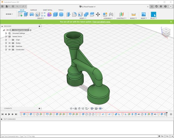

I have since tried using COIL to get a 3/4" thread, and through some trial and error, was able to get it to work nicely (see below); albeit the COIL approach produces sharp leading edges, which I don't know how to soften.
I suspect your solution will work much better and will try it.
Many thanks,
Jerry
