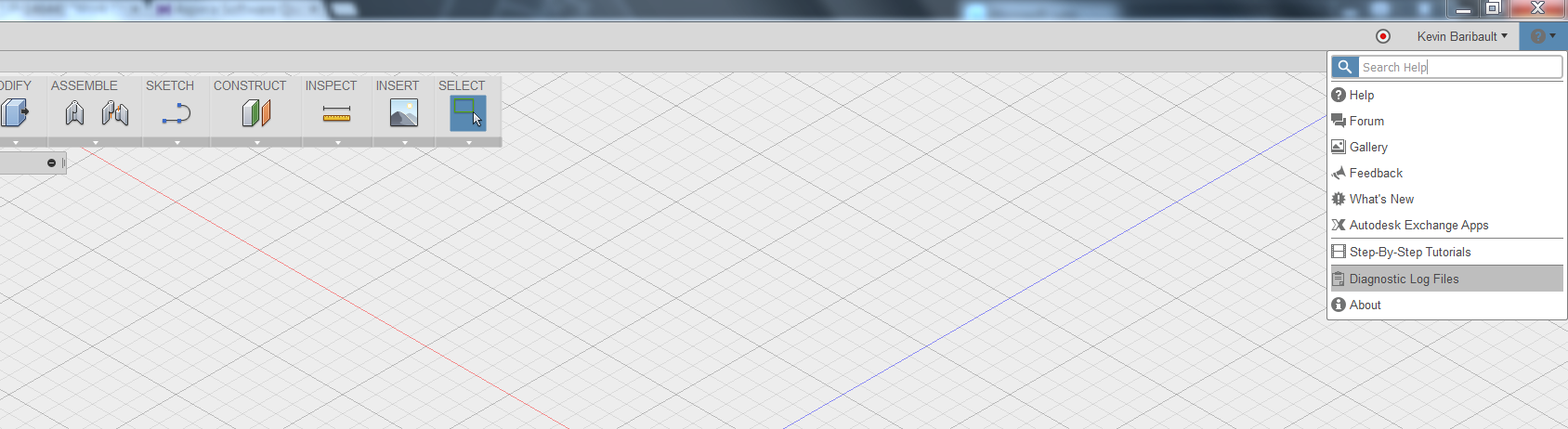

Hi elrumo,
In Fusion in the upper-right corner you will see a "?" drop down menu. Click on that menu and you will see an option called, "Diagnostic Log File".
Click this entry and Fusion will gather your log files and create a ZIP file which you can then send in.
In the meantime until we review the log files you can also see if it may be related to a bad browser cache file. For this you can delete the existing cache and have Fusion rebuild it. To delete the browser cache:
  1. Exit Fusion.
  2. Launch a Terminal window.
  3. Type: open $TMPDIR/Autodesk <Enter>
  4. This will display a Finder window displaying the BrowserCache folder. Move the BrowserCache to the trash.
  5. Exit Finder and restart Fusion.
If you have any further questions don't hesitate to ask. We look forward to helping!
