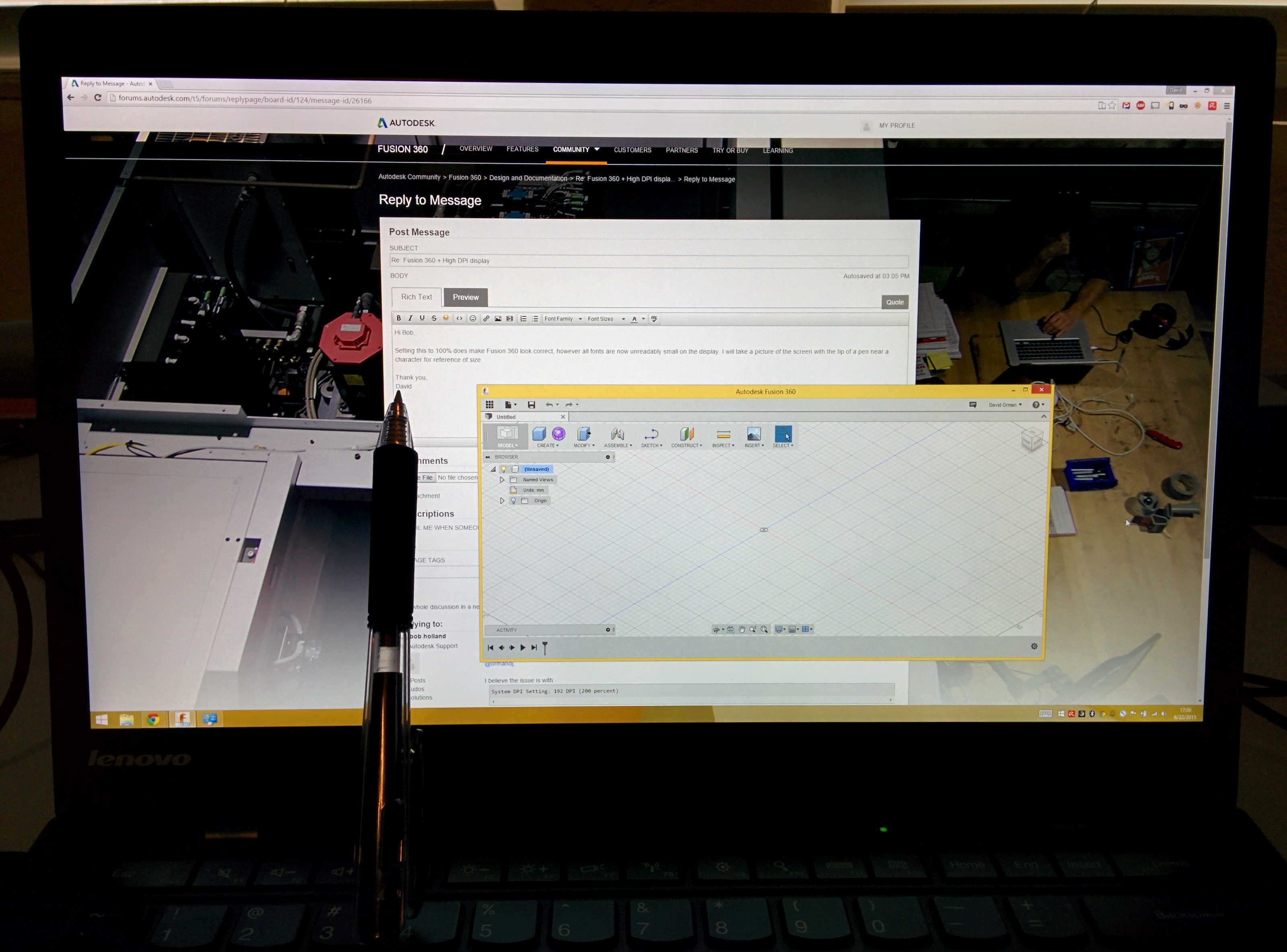

Setting this to 100% does make Fusion 360 look correct, however all fonts are now unreadably small on the display. I will take a picture of the screen with the tip of a pen near a character for reference of size.
http://ormandj.corenode.com/images/cad/360/text-pen-100-scale.jpg

Message 7 of 32
bob_holland
Autodesk Support
Autodesk Support
@ormandj,
Please try setting to 150 and let me know if that does the trick.
Thank you.
Bob Holland
Autodesk Product Support
Message 8 of 32
ormandj
The font size is more useable at 150% (but still small), however now appears clipped in Fusion 360 like the original screenshots/photo displayed. It looks like the graphical elements that contain the text in Fusion 360 are not scaling with the text size, hence the issue with the text being cut off when it is enlarged. Oddly enough, there appears to be plenty of 'space' for the extra text in the boxes, it's just being cut off at some invisible boundry point.
