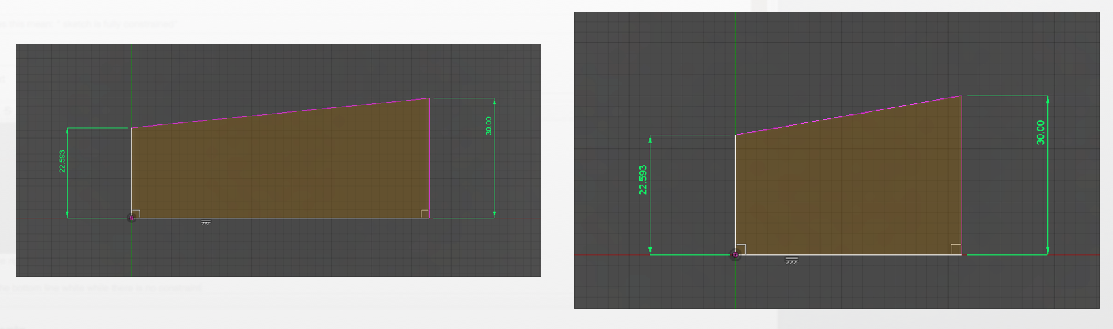

What I struggle right now is grasping the logic the solver follows:
Below two lines are white beccause with the other constraints and the sketch center they are locked down.
Adding a dimension left locks the top edge down - so now you cannot stretch the sketch left and right anymore
because the arc and the vertial dimensions lock the width in place.
but why is the right edge not white from the beginning? It is constraint as well!
And why is the bottom line white while there is no constraint that defines or restricts the left and right movement/scale

Claas, I just tried your example, and am repeatedly getting different behavior than you are seeing.  For your most recent example, this is what I'm seeing:
As you can see, I'm getting a "constrained" indication, with no fixed points being used.  And your other example:
Try saving the file, closing it and reopening it, I noticed that seemed to refresh behavior for me.  Also, under help be sure we have the same versions, I have 2.0.1514
Jesse
