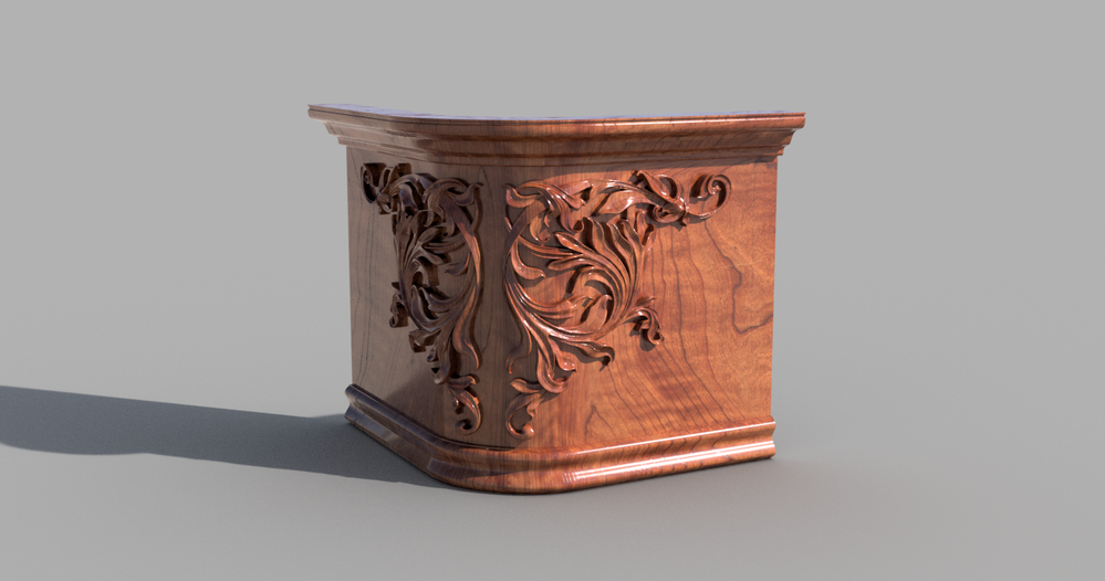

PhilProcarioJr
Been working on easy ways to do this....more to come later....
Here is a sample model with results. I could have done any pattern or design just chose this because it has been asked for so many times.
This took about 2 or 3 min to do.
