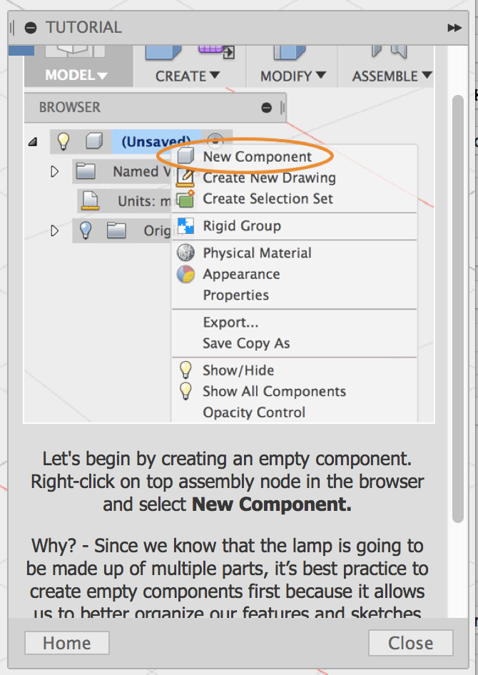

Ok. I downloaded and installed Fusion 360. I started going through the Tutorial. The very first step... "THE VERY FIRST STEP" says to right click on the top assembly node in the browser and select New Component.
What the heck is a "top assembly node"? Even the picture doesn't tell me what it is.
I can't get beyond the first step, and now I'm scared that I'll never learn this software. And there is no email address where I can get an answer to this specific question.
..tutorial Step 1

daniel_lyall
it`s just ADSK name for the tree, the bit you can see that is light blue (Unsaved) is the top assembly node just right click there.

TrippyLighting
All asseblies have one main component that everything else is attached to. From there you branch out like a tree. You may have one or more single parts attached to that top node or root but you may have also have another assembly attched to that main component. That assembly is a sub-assembly and may have it's own tree structure consisting of more components and perhaps other assemblies.
As such that "top node" is also ofter referred to as the Browser root.
