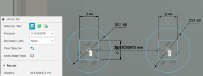

raymond_raymond_248193
i have a new problem please. and i'm sorry for replying this late.
the problem has to do with the file i attached to this mail: i designed the
highlighted form body prior but i noticed a mistake so i edited the body
and redesigned it but on thickening the form body, the thickening command
added another detail to the design and this doesn't bode well for me also
on finishing the sketch it keeps coming out as error. i don't know if
i'm explaining better but hopefully with the file attached, you can
understand and help please.

I am not entirely sure why you would even use T-Splines to create that geometry.
If you need to create sharp edged geometry, then surface modeling   is a better option.
That being said, your geometry violates some basic T-Spline modeling guidelines. The two faces highlighted in blue are n-cons with more than 5 vertices/edges. While that sometimes works, in this case you have also creased almost every edge.
That inherently leads to conversion problems!

The geometry is poorly constructed.
I recommend that you start over from scratch and Attach your file here after each and every sketch/feature for guidance.  Your Sketch1 (and many others) is not fully defined and I suspect if I ask some questions about the sketch you will agree with me the geometry in the sketch is not what your really want.
Are you attempting to reverse engineer an existing part from the real world?
If yes, can you attach an image of the original (or something similar)?
Why are these contiguous faces?
Wouldn't this be easier as one Extrude, Fillet and then Shell?
Where (in space if I take this to Inspection) are these circles?
Why duplicate sketch geometry?
Is this really the intended distance between centers?
Edit: As you start over from scratch using what was learned from this attempt - I recommend that you start a new discussion thread with a link back to this thread as reference.
