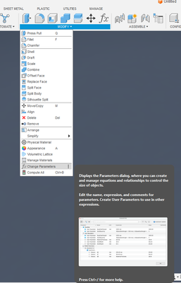

Message 19 of 20
g-andresen
are you talking about something like this?
günther
