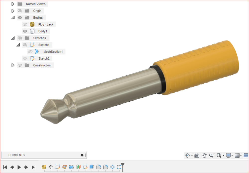

I did something same.
Message 5 of 8
wersy
in reply to: wersy
I just looked at my plug to check the diameter. Purely by chance I had made it exact 6.3 mm.
But there is still something missing:

joao.silveiraGDTLR
in reply to: wersy
Thanks! I was able to use your file and fill in with a cylinder.
