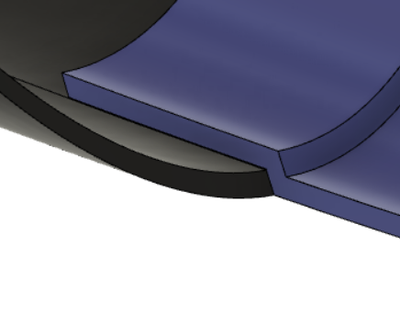

I would like to add a fillet between these two faces, yet it always makes a wrong fillet shape.
I do get this a lot for my designs so if there is a solution it would really be helpful!

The problem might be in the union of the two faces right where they meet.
Message 3 of 12
TrippyLighting
There is really no other solution than, for example hand modeling that fillet surface by surface.
I took this model into SolidWorks 2022 and it does the same thing there.
The reason is likely missing tangency between faces.

I don't have access to NX anymore but I believe the problem was the loft not connecting correctly to the face.
I've fixed the problem with the Merge Tool, although I had to delete my history first, after the Merge it was seamless and the fillet had no problem with the curve.

Interesting technique! It does indeed fix the problem with lack of tangency between the faces, and that's the reason the fillet succeeds. It would be nice to get this command available in timeline based designs.
