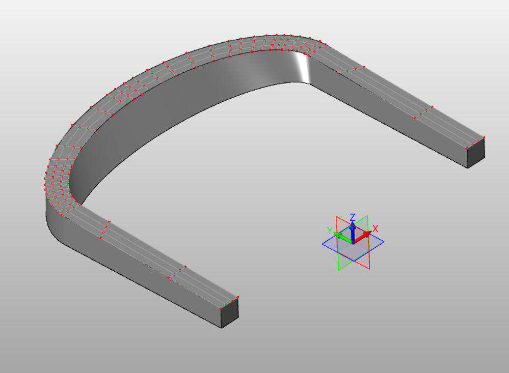

Here is the original loft with the NURBS control points show (in another app):

So the "correct" way to do this would be with an overbuilt surface and then trim manually. This surface is flat and only has 4 control points.
