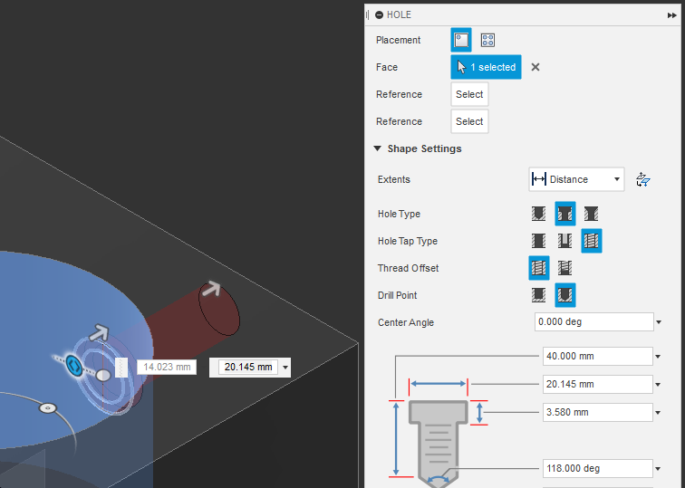

Created a simple extruded plate with lots of holes.  Tried to change the existing extruded holes (created from a sketch), and the Create Holes (from the MODEL > CREATE menu) is creating a hole at 90 deg to the axis of the existing hole (see image below).  Really strange ... If I use a "point" in the Sketch, the hole works file, it just doesn't work if I use a circle and extrude from it.

Holes are created normal to the selected face, which means that behaviour is by design.

The thread tool and hole tool work completely differently, the hole tool allows for holes in the sides of cylinders a thread will always be along the cylinder.
For what you where trying to do you should have selected the face first then drag the hole to its position\reference.

The first input that the Create>Hole command wants is for you to click on a FACE that the hole should be perpendicular to. You're clicking on the inside diameter of the existing hole.
Why are you trying to use the Create>Hole command where there is an existing hole anyway?
If you MUST do this for some reason, first click on the FACE and THEN click on the existing hole to set the position.

The file has a lot of holes from an early sketch.  The holes have be countersunk on the extrude face (not the sketch face) and threaded (so if I use the HOLES command on the sketch, the CSK is on the wrong side (yes, I could extrude in the other direction, but this part is already embedded in a complex assembly and it blows up if I try that!).  So I have a hole that needs to be CSK and threaded, for which the hole command would be great, if it would work with an existing hole ....
The problem is easily solved by adding a MODIFY > CHAMFER  followed by CREATE > THREAD command: I was hoping for a simple fix that allowed the hole command to be used that saved me from Machinery's Handbook to find the depth of the CSK!
