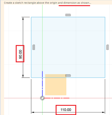

Create a sketch rectangle above the origin and dimension as shown...
Add a Midpoint constraint between the middle of the bottom horizontal line and the Origin.
What the color of the sketch.
What do you observe?
