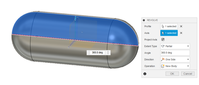

Step 1.
Sketch a Center Point Slot anchored to the Origin as shown below.
Step 2.
Sketch a horizontal line from MidPoint to MidPoint of the arcs.
Note the color of the sketch elements. (Fully defined.)
Step 3.
Revolve one side about the Horizontal line as Axis.
Step 4.
Shell selecting the Body from the browser and enter 1mm.

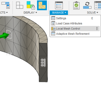

Step 8.
From the Manage tab go to Settings
and checkmark Remove Rigid Body Modes.
Oops, I made two mistakes - this is second mistake.  Leave this unchecked.
Step 9.
Mesh the geometry.  Observe the mesh.
From the Mesh Control adjust such that there are at least two elements (some recommend 3) across the thinnest section of material.
