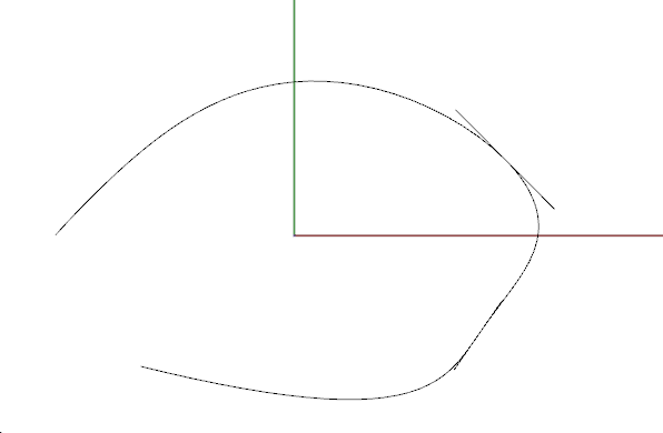

Hi! I am having trouble exporting Splines in DXF Format, When i try to do this it exports the pull bars which adjust its curvature, and not the spline itself.
Is there some way to export a dxf directly from a surface like in solidworks?
848 Views
HughesTooling
Just did a test using Rhino, what I noticed was I only got spline handles on points I'd edited apart from that the spline opened fine. The problem with the spline handles was reported a long time ago guess it never go fixed!Smiley Sad

This is what i'm getting:
DXF:
Actual FIle:
It has also done some weird stuff in the lower left corner of this design, exporting a feature that isn't even in the sketch: (see the deformed slot)
Opening in A360 Viewer gives this, Splines are there now but it is missing other features
