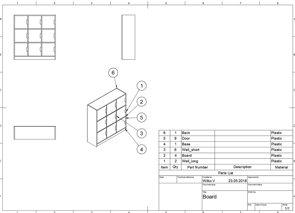

The main differences between your implementation and my implementation are
  • I followed Rule #1. This might be the most referenced link in this forum and is a good advise for implementing things. So I have a component for each body. The benefits are, that I could filter my timeline by activating a component, I can join components (no moves anymore) and all the components (parts) are listed in the BOM
  • I've always include the origin of a sketch and all sketches are fully constrained. That makes it much more robust.
  • Where ever possible I've used parameters (that includes user and model parameters). Now you can change the dimensions, change number of boards etc. and the design follows it nicely.
 Edit: Missing attachment added...

Ok, thanks, it looks really nice, I think I will switch to components from now on! 🙂
But there is one thing I can see: You didn't use linked files (which happens to cause most problems) and I really need it. It's good to know there is workaround for it if necessary, but the reason I used it was that we are not sure about the shape of these doors (there is a great chance we will generate a few series of furniture with different doors each one) and that's why they were linked, I wanted to have door model in one file.
