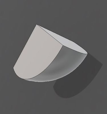

The second example provides visual clarity.    The BRrep to T-Spline Conversion tool produces forms that are only tangentially related to the parent.    As example, I've Intersected a Cube and Sphere to produce a non-symmetric fractional "orange slice":

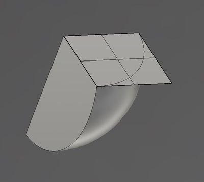

Let's Convert some of those surfaces from BRep to T-Spline, examine the results.    I'll Convert the curved face later; I'd like you to image NOW how that curved section of "orange slice" will appear as a T-Spline form for later comparison with the actual product.    First, a flat face:
As you can plainly see, Fusion has no capacity to Convert curved Edges- a primary asset in the T-Spline/Sculpt workspace!  The 3-sided, curved Profile is translated to 4 squares.   Unequivocally, a "dumb" tool.    Can the shape be produced using T-Splines in the Sculpt workspace?   Sure- and even with the T-Spline-preferred 4 sides. The best thing to be said about this lack of capacity: it is readily evident the moment employed.   A lack of capacity or failure of other tools- such as the aforementioned Primitives -is often several steps removed from the when or where the tool was first employed.
Now let's see what happens when we Convert the curved face.   Recall what you imagined it would look like?   Good.   Now regard the actual product:
The selected area in blue is the Face from our orange slice; the product here is an entire sphere!    As a secondary issue, notice the unasked-for sphere suffers creasing of a face near the visible nexus of slices.

Interesting find - the T-Splines results are indeed pointless.
But I think the main reason here is one should know that T-Splines is based on quad polygon meshes and not on trimmed surfaces.
BREP to TS to BREP works well when the conversion is done with clean square BREP surfaces.

Claas, the video was a great example- I should have said as much (actually, it does double duty here, as it offers a bridge for the personality conflict- more on that later).    It seems to me- maybe erroneously,  we'll see -that there are loop arrangements that can account for these edges.    A couple quick examples:
All quads, including the apparent triangle- the top Edge is actually 2 Edges.    Still, I appreciate the underlaying meaning- the tool does certain things, it doesn't do other things, and not having some other imagined capacity doesn't amount to a broken tool.   It may be a perfectly-bad example!  😉
