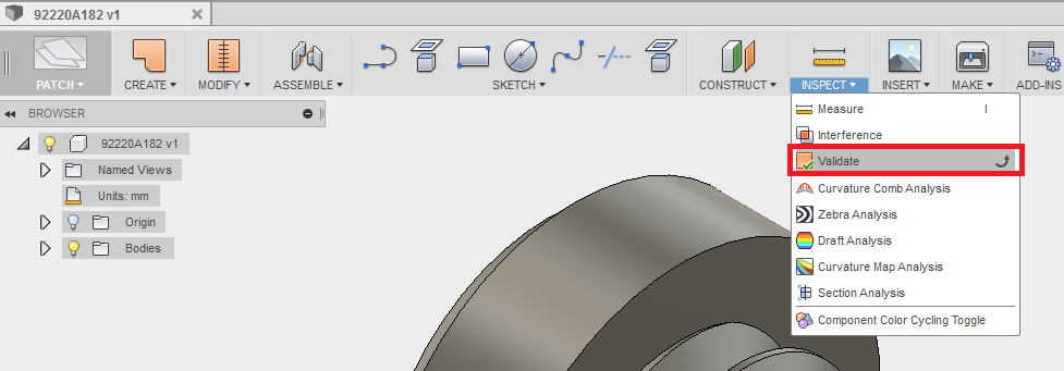

It looks like there is a problem in the translation process. You may want to run the Validate command.
If this doesn't help you may work around the issue try translating a different format like IGES or SAT. If possible, could you share with me a copy of the STEP file? You can e-mail it to nathan DOT chandler AT autodesk DOT com.
I hope this helps. Let me know if you have any questions.
