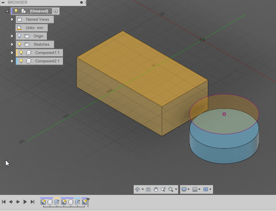

The reason this idea is archived is that it is, frankly, incompatible with the way Fusion works.  Fusion is a history-based modeler.  When you edit a feature or a sketch, you can think of it as time-travel.  We take you back to the point in time when this feature or sketch was created.  This is important, and necessary because Fusion has to prevent you from creating cyclical dependencies, and from creating references that are not possible to resolve.
As a simple example, consider this design:
In this design, there are two components, the yellow block and the blue cylinder.
If you then create a sketch where you select the top face of the yellow block, you get this:
if you then project the top of the blue cylinder into your sketch, you get this:
This circle in your sketch is now dependent upon the position of the blue cylinder component.  If you then move the blue cylinder:
Now, in order to compute that circle in the sketch (for instance if you change the size of the cylinder component) Fusion has to have the location of that blue cylinder at the point in time when the sketch was created, otherwise the circle will move.  And if you have other geometry in your sketch that references this circle, you could get wildly different results each time you moved the blue cylinder.  So, that is the basic reason why we move components back to their position at creation time.  Further, if Fusion were to allow you to edit this sketch with "newer component positions", you could then re-project the same edge into the sketch, at a different position.  Hopefully it is obvious why this would be a bad thing.
