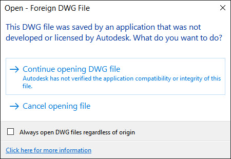

I washed the file through AutoCAD 2025 and received the message attached.  I went ahead and opened it and save as a different name.  I then tried to upload it to the Fusion Data Panel but it failed.  I have nothing else to try.  Sorry.

johnsonshiue
Hi! The 3rd-party dwg file is corrupted. I am able to use AutoCAD RECOVER command to salvage the file (see attached file). The geometry is extremely big and far away from the origin. I don't believe you can reuse the geometry for Fusion modeling purpose. I suggest you scale down the geometry and confine it within a box of +-100 meter in each X, Y, and Z direction.
