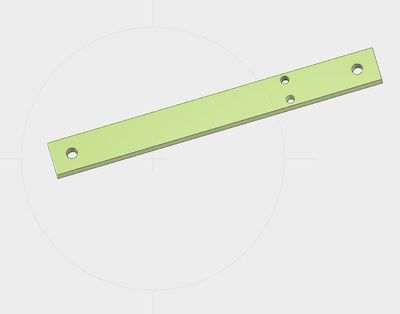

eg. my strut:
"Look At" gives this view - not suitable for a drawing with projection views.
I can select eg the left face and Look At...
Using the Orbit/Constrained-Orbit target (or whatever you call it), you grab the side target line and rotate the component to get it face-on ... but it follows the global orientation path, so you end up with the component at an awkward angle again.
So I don't get to a suitable view to create the Named view. So then I use the Align tool (which only seems to allow me to select the global origin planes). And then the parent assembly starts misbehaving as stated in the earlier post.
For now I can use the left hand face (pic 3) as a saved view. Not my ideal Base view though. You get awkward projections.

This is one area where using all components in one file versus external linked files really falls down. As well as this problem you also have the problem where every edit to the assembly forces an update in every drawing you've made.
For the problem you have it needs something like a view orientated with a joint. Just done an experiment, Look At works with a joint origin so if you can orientate a Joint Origin on a face Look At should give you the correct view.
Joint Origin created on an edge then select with Look At

Murdug
Ahhh, you've improved my life one notch!
I've implemented your suggestion, so while the Fusion team works day and night to offer a permanent solution for drawing views that are not assembly-position-dependent, I'll use this.
Thanks.
