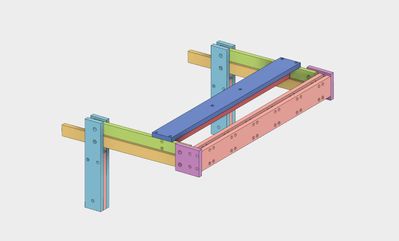

I have an assembly with multiple components, each named. I select a component, RC, "Create Drawing", and leave the "full assembly" checkbox un-selected. But the title block "Title" uses the assembly name instead of the component name? How do I get Fusion to grab the component names without manually renaming every component drawing I create?
The same question arises when saving the component drawing. The default name is the top assembly name instead of the component name?

The reason that the title block "Title" uses the assemblies name is because that is where the component was designed (I suspect) and therefore does not have it's own "Title" characteristic associated with it (i.e. Fusion 360 just sees it as some geometry associated with the full assembly design).
To get around this, instead of selecting "Create Drawing" when you right click the component instead select "Save Copy as". This will create a new design that appears in your project of just that one component. Once the design appears in your data panel, you can create a drawing of it by clicking the workspace changer in the upper left corner of Fusion 360 and selecting "Drawing>From Design".

Hi Mike,
Thanks for the suggestion. It is a useful work-around, because it also solves my component orientation issues I have in the current assembly, as I can re-align the "saved-as" component with no detriment to the assembly ... However ... I lose the link to my design. So changes to my "skeleton" sketch in the assembly does not translate to the stand-alone component. Unless I'm missing some useful trick of maintaining the link to the original parent assembly?
And now that I've mentioned my orientation problem, let me expand a little further:
I have a bunch of components with some joints enabling a pivot action...
I activate/isolate the green component, and of course it sits at an angle to the global coordinates. I intend to create a drawing of this component, but of course not at this angle, so I use the align tool to align it to the coordinate system (I tried local and global).
On reactivating the parent assy, the green arm now assumes its new orientation ... which is not what I want. I want it locally aligned with the coordinate system, but globally to adhere to its joints. But it's not.
The revolve joint is misaligned as well.
What am I missing here?
How do I align components for creating drawings without using the manual method of move/rotate in the drawing which I find rather useless. Every time I animate the assembly the drawings go wack.

Regarding the "Save as" workflow not maintaining the link to the parent design, there is a little trick here to prevent that from happening. Once you have saved the component out as it's own separate design, you are going to want to delete the component (and any joints associated with it) from the assembly design. Once it has been deleted, you should re-insert the component into the assembly and redo all of the joints. This will create an externally referenced (XRef) component within the assembly.
Then, should any changes need to be made, you can make those changes in the design which contains only that component and force those changes out to any designs that contain that component (you will be warned the next time you open the assembly that some components are out of date and need to be updated).

Hi Mike,
Thanks for the idea. Not a bad option, and at least you can align the external component as you please to facilitate drawings, and your drawing remains unaffected when animating mechanisms.
Still not a final solution for me though, because you lose your design references (eg. CREO's copy/publish geometry or Inventor's Derived part) to that component. Any changes in the assembly design (eg. a skeleton sketch from which you created the initial bodies) does not transfer to the external component.
I still figure Fusion needs to enable the orientation of an isolated component relative to it's own coordinate system without altering its global orientation, and if creating a drawing of that component alone, it should follow the local orientation. Pretty much as standard parts in the other CAD systems function. I know Fusion is not trying to emulate "other CAD" systems, but this to me seems to be a severe shortcoming.
