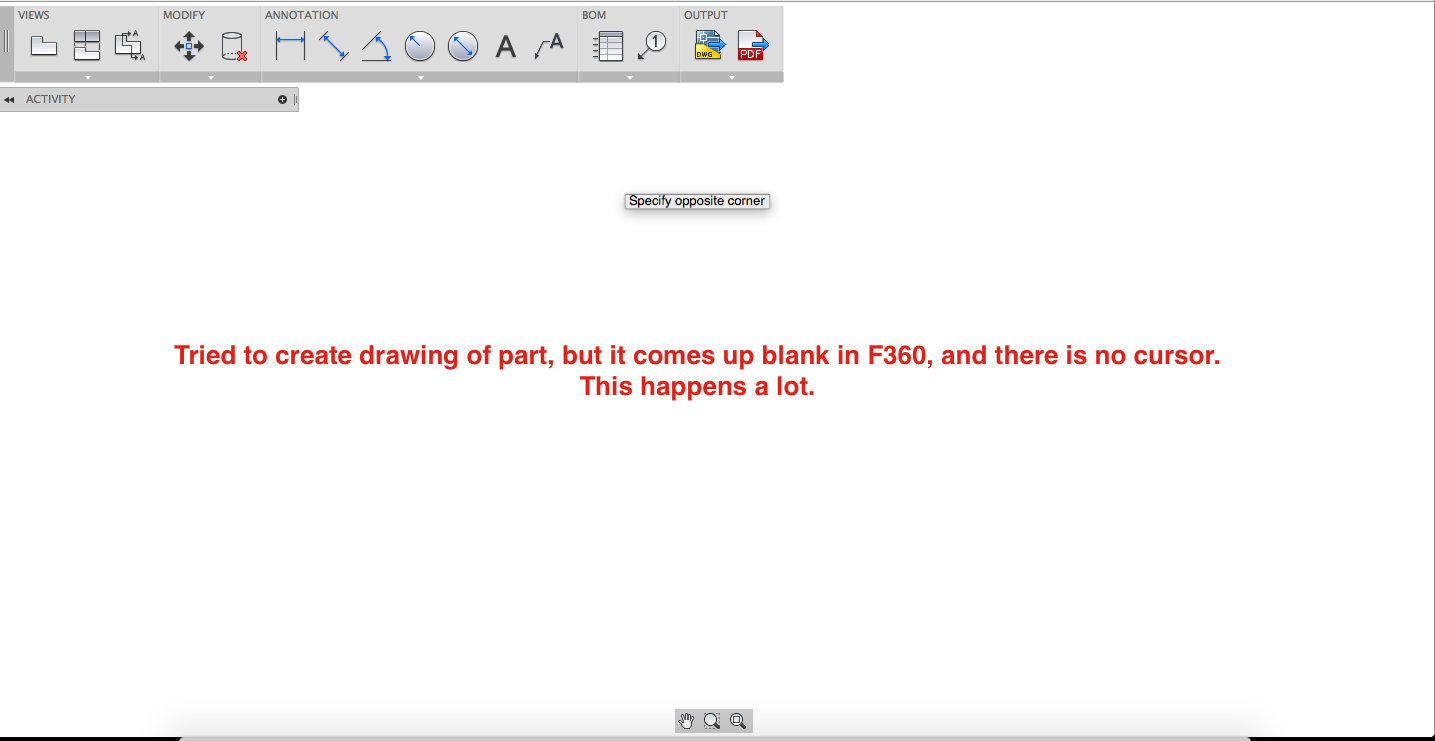

3.  Quite often when I try to create a drawing in F360, I get nothing but a blank screen that doesn't even show the cursor.  It often takes mulitple tries to create the drawing.

Hey, Nathan.  Thanks for the great response.  Yes, I can use the DXF export just fine.  I was just trying to go about things in a different way to "see what's under the hood" so to speak.
Re. the empty drawing, when I create a drawing from the Data Panel the first thing that happens is that F360 goes to a drawing screen.  The canvas is blank (as in the picture I included at the start of the thread) and then the paper/drawing template is visible, and I can manipulate the drawing.  It appears to me that the drawing generation hangs prior to the creation of the paper/drawing template and I get stuck on the blank screen.  Of course now that I'm at home and not the office I can't recreate the issue, but it was vexing periodically over the course of the day.  Thanks again!

From your screen captures it looks like you're on Windows, can you let me know Win7, 8, 8.1?
When creation of the new drawing hangs could you do the following?
1.  Launch Task Manager > go to Processes
2.  You should see Fusion 360.exe and possibly (depending on how far it got) AcCoreConsole.exe and AcIvServerHost.exe
3.  For each of these processes > Right-click > Create Dump File (.DMP file will be written to your %TEMP% folder)
4.  Send those files to me, christopher.miller at autodesk.com so we can take a look
For the design in the data panel that you're creating the drawing from, is it newly uploaded (never been opened) or has it been opened before?  When you see this hang happen is it on the first drawing, or do you have other drawings already open?

Hi, Chris.  I'm use OSX Yosemite when using F360.  I run SW in Windows.  Do you want me to send the diagnostic log file?
The issue happened with an old part and I did not have any other drawings open.  Thanks for your help.

Yes, the diagnostic logs (expand the Help menu in the upper right > Diagnostic Log Files) would be great.  Please send them to christopher.miller@autodesk.com.
When you hang are you force quitting Fusion using Activity Monitor?  There are two other processes related to drawings, AcCoreConsole and InventorServerHost.  If you are force quitting Fusion 360, please check (and force quit) these if they are still running.  Finally, if you are encountering a Customer Error Report (CER) dialog please send the report in and let me know your email address so I can find it and take a look.
