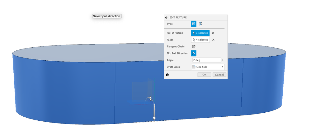

As a recent fairly advanced "switcher" from SoldiWorks to Fusion 360 I sometimes find some unexpected problems to seemingly simple features. Here for example, I'm trying to draft a box AFTER filleting it. This works fine for 'Tangent' fillets, but it can't seem to compute the same for 'Curvature' fillets.
Drafting the box prior to filleting it results in unwanted geometry.
Advice? Thanks a lot.
1. Filleted box.
4. Change fillet to 'Curvature'.
5. Draft errors.
6. Bad example of drafting after fillet.
