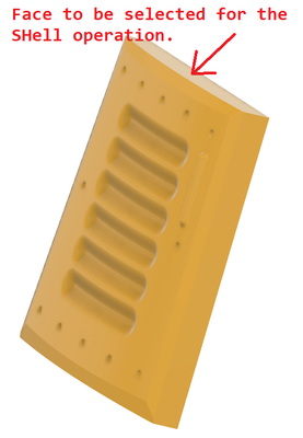

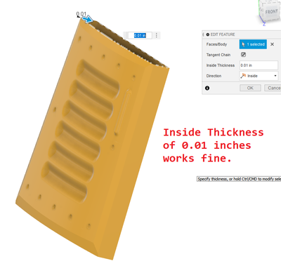

I'm having trouble with the Shell operation. It succeeds when I select a very small value for the Inside Thickness (0.01 inches) but fails for anything larger, even 0.013 inches. My actual intent is for an Inside Thickness of 1.71 mm (which is basically three layers when 3D printing the object) but I can't get it to work for any value anywhere near that., although it works for really small Inside Thickness values.
I just have no clue what it is that it doesn't like, why it can Shell it for a really small Thickness value but fails for even slightly larger values.
It would REALLY HELP if, when it's doing the Shell process and encounters a problem, it would HIGHLIGHT the problem area in the model so that at least I could TRY to change something to  its liking.
Also, just a side observation: I can save the model as an stl file and bring it up in the PRUSA Slicer, select zero infill and any number of vertical shells and it, PRUSA Slicer, is able to accomplish basically the same thing that the Fusion 360 Shell command is supposedly able to do. But whatever programming approach Fusion 360 takes doesn't seem to be able to handle it. And, no, doing an effective Shell in the Slicer doesn't solve my problem because there's other operations I need to do to the model after it gets Shelled.
My f3d file is attached in case anyone wants to give it a try or try to figure out what it doesn't like.

The point is that the Shell is working at a thickness of 0.013 and failing for anything thicker. How does poor surface quality allow thin values but fail at larger values?

While I agree that Fusion could be better at highlighting problem areas, I would like to point out that it does exactly what you request.  At .1 in, this face is highlighted:
now, this is not exhaustive, and I have seen cases where fixing one problem just leads to other problems.  And, the highlighting does not always show up, I'm not sure why.  I do think that your "dimples" might be contributing to the problem.  Here is one hear the top of the model:
near the upper left there is this one:
These are clearly going to cause problems.
These sliver faces are also part of the problem, I suspect:
Remember:  Shell is not magic.  Shell has to:
  • offset every face of the body by the shell thickness (except those removed)
  • add in new faces where the removed faces were to bridge the original surfaces and the offset
  • stitch those offsets together
  • subtract that from the original
so, it will fail on some geometries.  They better input it has, the better chance of success.
