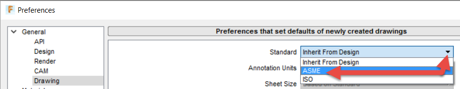

krithika.sundararajan
Hi Maasen2010,
As TheCADWhisperer has already pointed out, this is controlled by the Standard that is selected during drawing creation - the text is aligned with the dimension in ISO drawings, it will be horizontal in ASME. To confirm what standard you are using, you could expand the Annotation Settings menu at the bottom of the drawing:
If for some reason the menu shows ASME but your dimensions are still created with aligned text, that is a bug. In this case, it would be helpful if you can provide a screenshot of the Drawing section in the Preferences dialog as well as clarify what settings you are using in the new drawing dialog, design units.
