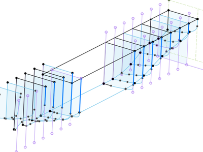

Hello guys,
I hope you will be able to help, I am struggling since months to design an oil and gas vessel hull.
I am working for a friend on a project to design and 3D print a mould in order to use resin and fiber glass to do a model.
My friend even paid some contractors on Malt and Fieverr but all of them were unable to deliver a proper file usable and editable. I am able to get a nice form myself but it's buggy and I cannot use shell fonction or combine to get a mould shape.
I need to design the master first (the hull) so I can either directly 3D print it or get the mould shape and 3D print it.
I tried with solid, surface and form but end up with the same issue. The 2 files attached are the same design but with 2 different loft approaches:
  1. Using only 2 profiles with 4 rails and sketches used as template for rails position.
  2. Using mainly profiles and multiple lofts: I get a form but top and side are not flat and shelf function is not working.
2profiles+rails2profiles+railsonly profilesonly profiles
Option 1 results in a non valid form:
non valid formnon valid form
Option 2 seems better but the top and side are 1 flat surface + the last loft create a curve on top edge when it should straight.
option2option2non flat surfacenon flat surface
The 2 f3d files are attached, I really hope you will be able to support.

wersy
Hi Laurent,
The order is not correct.
First draw the longitudinal lines. Then the frames are created via intersection.
Michael

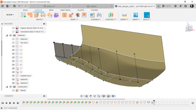

l.cariouVF6EP
I just spend some time on it and I don't see how to do it. In fact i don't understand why designing the profiles or the rails first could have an impact.
I tried to rework the big profile and by simplifying it and making it with the same qty of spline line points it works better. The top surface is now a plane, unfortunately the side face is not a plane. I don't understand because the side on the 2 profiles are straight lines and the rails on this side are both 2D.
not planenot plane
I tried by mirroring the profiles before doing the loft but then I cannot shell the form. So frustrating.

TrippyLighting
This is a complex shape and a single loft is unlikely to give you the result you are looking for.
Depending on what the overall goal is, this is not a beginner project. If you just want to model for 3D printing Fusion 360 is a fine tool,. If you are after a very accurate  reconstruction, Fusiosn 360 might not be the right tool It simply does not have the surfacing tools needed.
It is not the case that more data e.g. more spline points, more profiles/rails give a more accurate shape. The opposite is the case when working with NURBS surfaces.
Lets start with the splines. This spline is not  bad, but it can easily be better. That wiggle in the curvature can be removed by deleting one spline point and working with the remaining tangent handles. In fact a 3 degree control point spline with 4 control points will do better.
Message 7 of 27

laughingcreek
I haven't had a chance to try my hand yet. but one thing I've observed from the attached canvases is that frames 8-10 are identical. (11 nearly so but the side profile shows there is a slight difference even though it doesn't show on the frame profiles).
that means that those frames should be a straight extrude, NOT part of a loft.  this is VERY fortuitous because now you will have a surface to define curvature at the edge of the lofts that extend off this middle section.   this area needs to be the first surfaces created.  trying to loft thru this section from adjacent areas will never achieve the correct surfaces here.

davebYYPCU
There is a sketching / modelling error here (my Stern area) with this sliver section of the sweep body, that was then cut to shape, leaving a tail here.  Caused me some trouble earlier in the day but thought it was fixed.  You can probably get that sorted, but I am just about out of here.
I was able to boundary fill, but the Shell at 3mm failed.  I unstitched the surfaces and was able to thicken each panel to 3 mm. Combine joins all but that one body causing the error.
Sorry I could not get it fixed, but that will definitely be the position of the cause of the problem.
For a plug, why would you need a skin?
Might help....

davebYYPCU
First rendition, having done it once a second attempt may be more efficient.
I learned a long time ago that these types of line drawings can be inaccurate.  I therefore plump for the longest canvass, develope the early sketches and interpret what should be.
I will highlight the main problem I had, was the flat bottom keel, two sections were depicted in the top view but the piece in the middle was missing, hence 14 and 15 look bad in your pic, so then you refer to front and back for contours, and as Alex noted 8 - 10 are the same, so I used Tangent spline to connect them, for a cleaner Loft, over those line contours.  You should note there is no line contour at position 17.2, where the bow finishes at the keel, my curve accords with the thruster tube.
I agree with Trippy it’s what I can get given the Canvass quality, and Fusions Lofting rules, and stated output as a 3d print.  Most likely the contractors took the front contours literally.
