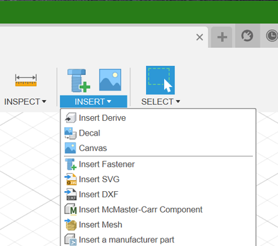

If you are trying to import the decal into Fusion:
Then resize, or better yet Calibrate, and move it onto the surface of your model.
