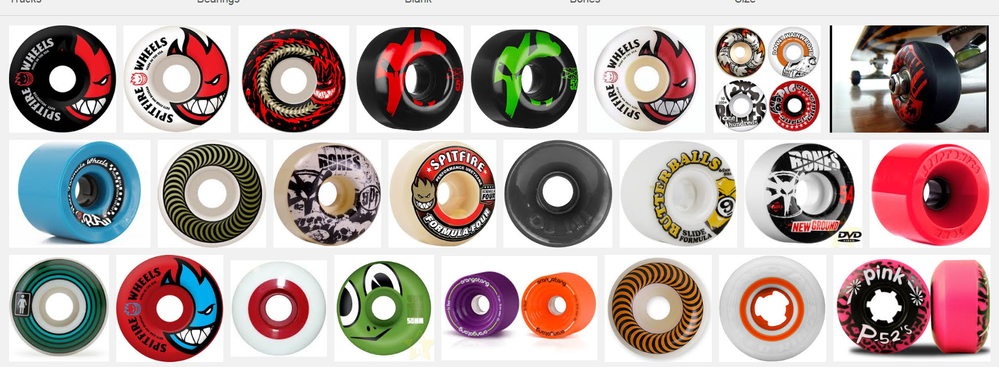

This is a known issue for a long time. Reported internally as FUS-12655. I wanted to make skate wheels with decal graphics like this:
There is another effect reported as a related bug. If you place the decal and later make the hole in the middle, it moves the decal. So it's truly impossible.
