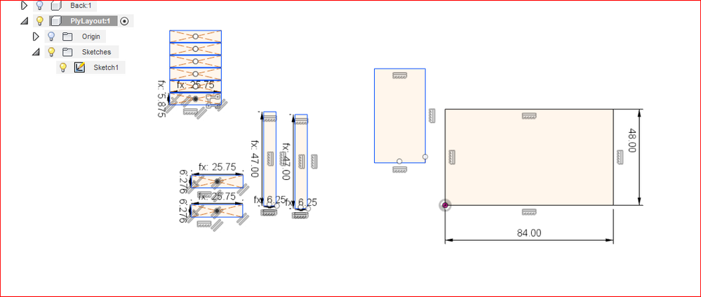

Would anyone mind coaching me through or providing an example of how they would go about creating a cut diagram for this model here? I have tried the program cutlist. It uses the exported BOM from fusion but its all jacked up. Any advice or example using my model would be super helper for me to learn from. Thank you.

The goal here is for my woodworking plan in the shop. All hand work. I will be ripping and cross cutting sheet goods with a table saw, and I want to optimize my materials. Most woodworking plans tend to come with a 4x8 plywood layout with all of the items laid out on it in a optimized way. I know there is the nester program and several tools to sort of automagically do this, but they are not good and quite complicated. They may work for a CNC layout but not for general use.
I know sketchup has support for this, and I know that fusion doesnt really have support for it yet. I'm generally just reaching out to the community of experience, asking how you would do this if you needed to, and provide an example if you have time.

I checked the file,
you have 4 individual parts, the rest copies.
You can't print anything directly out of Fusion to paper, as far as I know,
there will be secondary software hardware involved.
If you don't need the piece of paper,
then I would use Nester. its a free GitHub Addin.  search tapnir/Nester.
(but it is no longer installed here, and there is a demo video on YouTube.)
It will extract components to a material board with planar joints.  You can reposition for grain and layout easily,
DXFer is also a free Addin, off GitHub.  You need a DXF file handling capability for it.

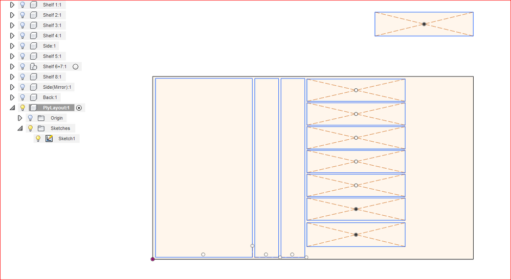

In your case I would create the master sketch, with your 4 rectangles, (copy / paste)
copy, side and inclined shelf, (Altered for true length)
pattern the other 5 shelves.
Use the Move tool in Sketch to position them.
This is best fit but grain direction not considered till having the last inclined shelf not fit the plate.....

This is a cool idea. I have a couple more questions about it though.
When you create the new component, and just copy all of the sketches to the plywood sketch, how did you do the angled shelves? Did you just have to copy that component out, rotate it flat then measure the actual dimensions of the shelf?
And lastly, I think I really like this sketch layout approach. It seems much more simple and the nester program. Am I able to place text on the sketches to label, or even color the sketches to separate visually the different sized pieces?

The angled shelf - nothing done in a manipulating way, creating a new sketch on the face of it will not work with out the projection of the long edge,
no, just made a copy of the std shelf and changed the width by deleting the fx dimension, adding the correct value.
I add a perpendicular construction line from top front of the shelf to the underside.  Measured the True Width, and then changed the width dimension in the plywood sketch to that value.  There are parametric ways to do it.
Simpler than the Addin, Nester, not really.  Did you find the slatted chair video?
I would not like to do any more unique parts this manual way.  (Three and a half)
Visualisation -  in a dxf handler, software dependant, mine does.
In Fusion, not easily,
you can add text, colours never noticed.
yes you could make a sketch for each individual, being overlayed, playing with light bulbs would then show them, or not.  Step up the Timeline would work too,
