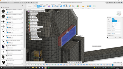

how do i make this instead of cutting all the way through to cut at an angle making a vent? i hope im making sense..

thats not exactly what im looking to do, im going to create a vent for the square hull body on the side profiles, i can show picture example

i wanted to create scoops for the square hull body on all side faces, example here like the scoops vents for airplanes, basically vent scoop for the square body on all side faces1221-P-M-K(2493).png

no. i want a angle on bottom and a angle downwards from the top i can draw it 🙂

Is something like this what you are attempting to do (see Attached file)?
Message 15 of 20
oystein.l.l
Yes exactly just both should be symmetrical, looks good how did you do it?
