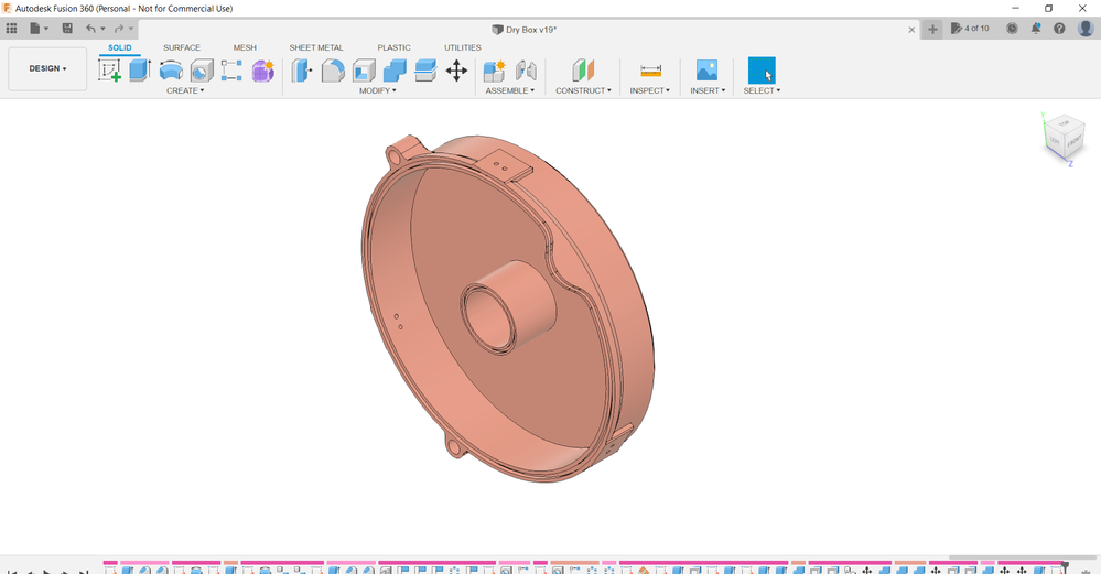

I am trying to extend a lip that adds thickness to the edge of a box, all the way around, but I am having trouble getting it to go around a part of one half the box that extends into the profile of the second half of the box. I have tried different methods like project to include 3d geometry, but I cant find a method that works, any help that you can give will be greatly appreciated.
Box OverviewBox OverviewPart of box half that extends into the otherPart of box half that extends into the otherBox BottomBox BottomBox TopBox TopPart that the lip needs to follow aroundPart that the lip needs to follow aroundCurve That I Am Trying To Follow With The LipCurve That I Am Trying To Follow With The LipAutodesk Fusion 360 (Personal - Not for Commercial Use) 14_02_2022 20_35_43_LI.jpg

Hi ,
is that what you need ?
davebYYPCU
The lip in the top half should be a Sweep around the path from the Bottom's edge after body 7 is combined.
Might help....
LiamIcely
Yeah thanks, thats exactly what i need, who did you do it?
aliobidi
here is your file
I just make extrude and cut it then just combine join then chamfer
