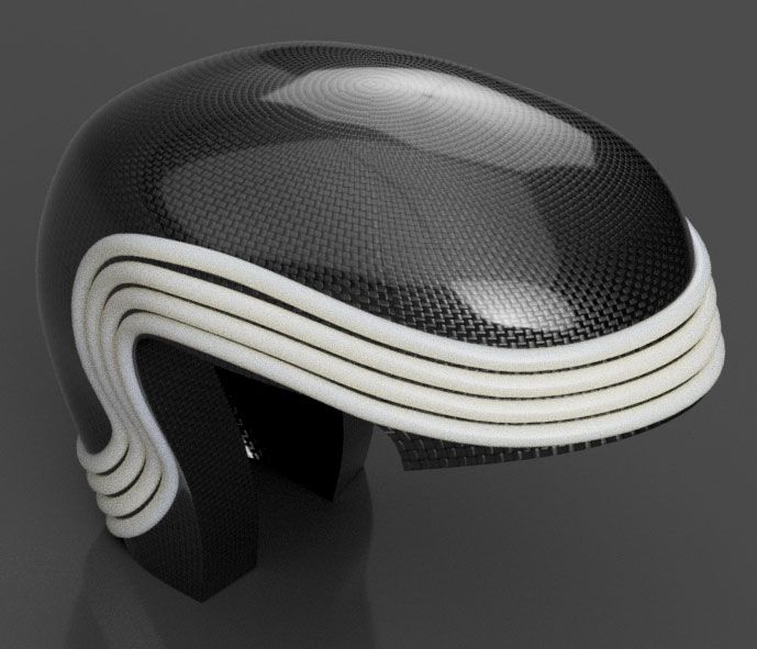

Yes I did. I've made you a screencast but you'll have to wait a bit while it processes.
You could certainly move the spline points around after the fact, as long as you set things up right. I made one spline and then offset it multiple times. So I just refined the first one and the rest maintain the spacing. If you want to move them individually to correct the resulting pipe spacing problem around the curve of the head, you'll have to break the offset constraint so that they become unique.
Also they're kind of finicky. You'll need to make sure none of the resulting 3D paths on the head turn too sharply at any point. You'll see me deal with this situation in the screencast.
Here is a teaser shot while you wait for the screencast.

chrisplyler
Okay, here you go. Just remember that you said you would kill for this. So if I ever need anybody taken out, you're my guy. You owe me one assassination.
Message 7 of 8
chrisplyler
And yes, I am able to project onto the head from more than one sketch and get the ends to line up. But I think it's going to become a pretty annoying workflow as you get further along...
