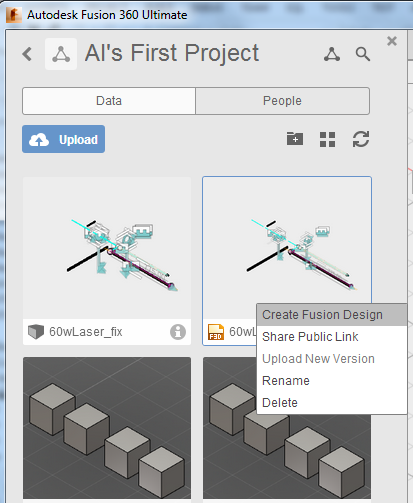

Once You get the fixed file You can use this workflow:
Maybe You know it, I'm posting it because it could be benefical also to others.
1. download the "60wLaser_fix.f3d" Your local drive.
2. In Fusion or on A360 Upload the file. Choose any target location in your Project.
3. After a while You should see the "60wLaser_fix.f3d"  with the preview in Fusion Dashboard panel. (try to refresh the panel if necessay)
4. Now RMB on the "60wLaser_fix.f3d" in Fusion Dashboard pane and choose "Create Fusion Design"
5. After a while You will see second file "60wLaser_fix.f3d"  with small grey cube icon.
6. now open this newly converted design
