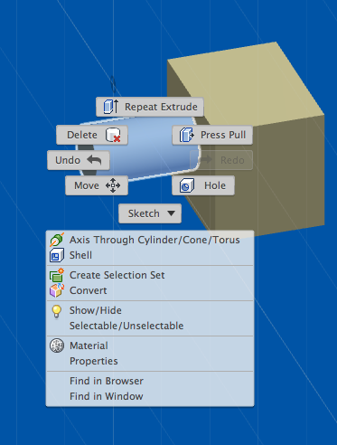

Hi all...some questions on sketching (see attached picture of some bolts going through a plate):
-I created a sketch with all of the geometry I needed
-The base plate needs to stay the same place
-the bolt housing needs to rotate by 12 degrees upwards
....If those were separate bodies, I would be able to do that easily, but they are not...everything was created in the same sketch.
Questions:
-I cannot see how to copy a sketch into a new sketch (then I would be able to save all of my original work, and delete the parts I don't need out of the new sketch and make bodies just out of the bolt housings
-Or, I cannot see how to select specific parts of the geometry (that originate from a single sketch) and make new bodies out of them.  In this way, I would select all of the bolt housing pieces and click "make new body of of these pieces" and then be able to rotate them
...because right now, when I select Move-->rotate, everything wants to be the target of the Move command.
Ideas?
Thanks!

Hi nkloski
One process that I use is to create a blank sketch and project the other sketch, sometimes tis process helps to machine to define one 2d drawing so the lines are closed (still using artcam and on the process to move to hsm ;)).
Open the sketch you want to copy from the tree and “crt+c” to copy the lines you want and then in the new sketch “crt+v” and will be there with the move command active.
Best Rishi
Message 3 of 10
Oceanconcepts
If you are in Direct Modeling it is possible to just select the faces you want to move, then select the Move command and reorient the manipulator to have the axis of rotation you want, then move the faces.  Once you start the rotation you can enter in the specific numeric value you want for the angle. You can't do this in parametric/ capture design history mode- one of the reasons I'm still mainly using direct modeling.

Wow...thanks, everyone!
I guess, being a "new user to Fusion 360" I did not understand that some features were just not supported or do not work like they do in other "modes".  I understand that there are differences to working with Forms and Sketching, etc....but that the constant presence of the Design History function actually prevents you from doing things in _all_ modes.  That is weird functionality to me....it is like the design history function is acting like a "super mode" that affects your entire environment (negatively in this case), and that if you don't know to turn it off, you just lose access to all of the direct modeling features!
Would be great if someone could point out a place (I did not see any) where that tradeoff in functionality is described, since new users would just "start using" the program and would probably never think to turn off what they think is "an awesome undo feature" to get functionality they might want......unless that functionality was described somewhere.
Thanks!
Nick Kloski
Message 6 of 10
Hi I would default to Direct Modeling mode at "Preference". In fact that was exactly what I did. There are things that the Parametric Mode cannot do especially the Move Command on some sketches like "Offset Planes" (I actually added that as an Add Feature Request). If you want to use the Move Command at the Parametric Mode you might have to Change to Edit Face mode. But sometimes it would not work and you have to plug in values at the "Parametric Expression". Then you will ended up choosing the Basic Feature Mode.
Until they can make the Parametric mode better and more stable I would suggest to just default to Model, Sculpt and Patch workspace Mode.
By the way in Direct Modeling mode, the "Push Pull" command works beautifully. Say you wanted to make a hole smaller you can Push Pull the inside of the hole. You wanted to decrease the depth, just push pull the bottom up. If you wanted to eliminate the hole completely, this is a little trick I used, "Extrude" from the bottom using Join option  all the way passing the surface, then select the protruded part and select delete. The hole is gone ! It works. Try it. Enjoy!
