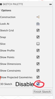

When I sketch any item, it shows me the X Y coordinate system for each one.
This kind of gets in the way and makes it hard to see what I'm sketching.
I cannot find a way to turn it off.
Has anyone had any luck with this by any chance?

uncheck 3D sketch option in sketch palette
