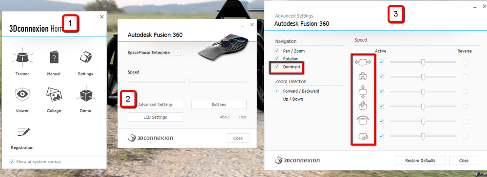

There is a 3Dconnexion setting called "dominant" which should help isolate the axis of movement. Is this what you are talking about? This is where the setting is, and in the image you can see how motion is isolated based on how you use the device.

g-andresen
1. click the Home Button in the right upper corner
2. disconnect and connect
3. reset all preferences
4. check for update  (10.6)
günther

That's fairly normal and happens in Solidworks as well.  This is because when you twist the knob you are also tilting it to the side a little bit.  It's actually fairly difficult to not tilt it some while while twisting.
One thing you can try is to turn on the "Dominant" flag.  Open the 3DConnexion control panel and go to advanced settings.  Under navigation, check the box for "Dominant".  What this does is to only allow one type of movement at a time.  So it will only allow rotation around one axis at a time, that is whichever one has the strongest input.

Yes, I already had the dominant setting enabled. For my gif video showing the roll I completely disabled all the other axis. This is how Fusion interprets free orbit even if there is no other axis input. It happens with the mouse as well.
