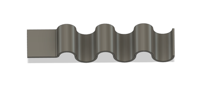

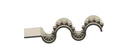

Sorry I'll make myself more clear.
I want to imprint this pattern
tx5hDoW
onto this pattern
IoanJId
and I want the first pattern to follow the contours of the second pattern.

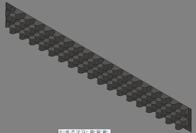

I've been trying to do what jhackney1972 did but I continuously fail.
I'm trying to get the waves to be 0.5mm in height, length, and width and I want them in rows of 40 on a 4 inch cylinder but I can never get the waves to line up properly.
Clearly my math is failing me somewhere.
DZWz3uD
There is a gap between each one and I'm a bit clueless on where I went wrong.

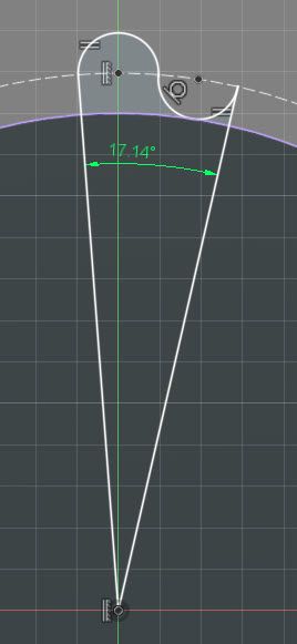

jhackney1972
The dimensions you give do not seem correct.  A 0.5 mm sketch is an extremely small sketch plus you are mixing units when you say your cylinder is 4 in, diameter or radius you did not say,  The measure shown in your screen capture is 13.21 diameter which does not match anything.  In the sketch below, which is one segment of my model, note the bounding lines go to center.  I also originally dimensioned the curves at 1" to originally get a general size but then removed it to let the segment angle control their size.  All the curves have an equal constraint applied.  The construction circle is just a floating guide circle for the curve centers.  The angle of the segment is the number of my, later to be applied, circular pattern of 21 divided into 360.  If you attach your model, the forum users can help you out for sure.
