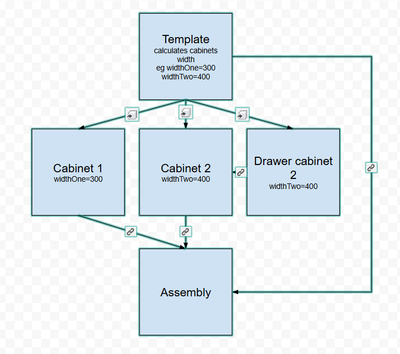

Mublio
Hello Rhaoma,
I have made a similar system, using this structure. This works, BUT if you have configured components, these currently take ages to update in the Assembly.

Thanks for your input. I ended up enrolling for a 30 day trial version with my account during which the configurations feature was made available, essentially using the approach described by @Victoria.Studley . This made it possible to contain the design as a single file, which was nice.
The templated approach is a good idea though, and one I actually used for the general project to link all my assembly components together. I just hadn't considered using it for the drawer sizes.
