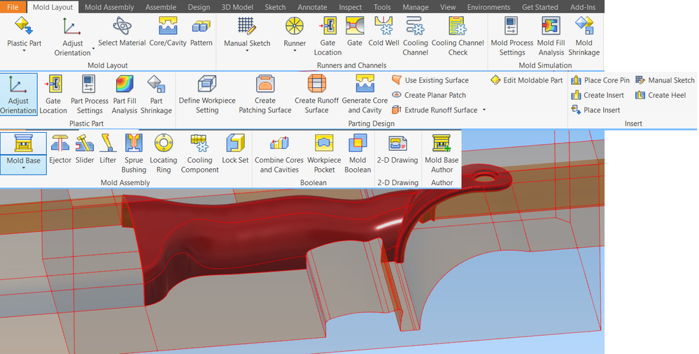

Sounds like Autodesk Inventor Professional tooling and Derived Components.  By the time you figure out a robust technique in Fusion - should pay for itself....
