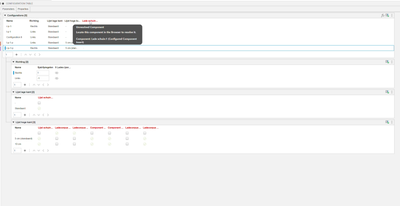

@gautham_kattethota I just had another instance of this issue occuring. Also, quite a few configurations where deleted, and one "Configuration 6" was added. In the screenshot below you can see the configuration dropdowns before (v94) and after (v95).
I noticed the configuration table of the corrupted version (v95) looks very different than the one thats still in tact.
v94
v95
Now that I look at this table again, this configuration table belongs to a whole other file that I have been working on. Somehow the file appears to load a configuration table that does not belong to this file.
In the browers and timeline everything looks just fine, see image above.
Hope this extra information helps!

@deepali.pulate @gautham_kattethota @EvanGu
I just had the same issue with another file, bit this time all the configurations disappeared including the default one (which is impossible to do manually).
What is truely worrying for me is that the problem persists even when I restore an older version. It appears like all the configuration data is just gone. This file is also derived from the original "Cabinet assembly" and edited like I described above.
I really hope you find the source for this behaviour, because I desparately need to use these files for our projects. Right now it is impossible to design any of our cabinets.
Kind regards,
Koen

Message 19 of 22
Mublio
Hello Gautham,
Thanks for the quick response. I am familiar with the clear cache trick, but forgot to try it this time. A combination of Clear Cache + restoring an older version did the trick for this particular file. Thank you.
I would be happy to have a call to find the root cause, because this keeps happening all the time. I will send you an email.
Kind regards,
Koen
