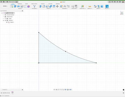

Hey, I am trying to make a simple ramp but I need one corner lower than the other. How would you make this. The gray one is an example. Thanks, Matt

Start with a simple frame and a curve. I used a 3 point Spline and fully defined it.

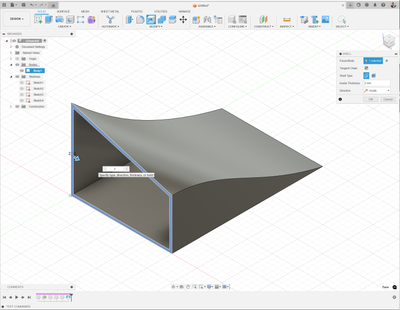

 There are a number of ways to do the next part but I will create an Offset Plane and then
repeat what I just did with a different height frame and curve.
I have then Projected the parts of the sketches I need into other sketches and joined everything
up so I have two curve parts joined with lines that will be my ramp.
I now use the Loft command to join my shapes together and the joining lines as my Rails.
I can use the Shell command to hollow it all out if I want.
My Quick and Dirty ramp is a little different to the one you have in the mp4 but the
basic principle is the same. Take careful note that all of my Sketches are Fully
Constrained. This is another typical beginner trap that causes endless problems.

I have attached my meagre effort for you to step through and see how it works.
