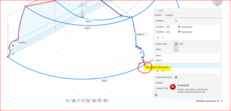

So I want to create a coffee cup's lid that look like this right?
Since it has some weird curves, I want to create it at 0, 90, and 180 degree sketch of it and then use loft. Just by looking at my sketch you can see I manage to get the shape of the lid.
I also PRECISELY draw the guide rails with project to make sure the 3 guide rails intersect with the profile, yet somehow when I use loft it always say that either rail doesn't touch the profile (it does lol) or the tolerance problem. Even if it somehow work, there are hole in the loft too.
I HATE loft. I been stuck here for days now, please can someone help me?

Plain to see, the red blob means what it says, bottom rail is not connected to this profile HERE.
Trying to do too much in one go?
Step timeline.  Make your dimensions.  The file should update.
Might help...

The thing is, the line DOES touch the line, and I did dimention it to the correct diameters and use project to make sure it touch
I'm sorry for forgetting to share the f3d file, it is in the comment section now, please help if you can.

You did the right thing when you projected the profiles to make sure that the rails touch them. The only issue is that you chose the wrong loft for this, where you selected the solid loft, which is terrible for very thin profiles like these, so if you try the surface loft, it would work, and then you can turn it into a solid by either thickening it or boundaryfilling it then shelling it, both works great, but make sure to go for rounded thicken if you choose to thicken it and rounded shell as well for the other option. The thicken is easy for you to try, so I applied the second concept of boundaryfill+shell for you to checkout in the .f3d attached.
So if there was anything wrong at all, it was that some rails were not touching the profiles in some places, and that's because you didn't apply the projection of profiles concept everywhere, but the main pain you felt where loft wasn't working is mainly because of the solid loft behaviour, where the surface loft is much more forgiving, or I should say capable.
Please find attached a cleaned version of your file sketches with the above I mentioned applied.
Note: Your file needs alot of work, as your sketches are poorly created and not defined, but it will do for now.

It was wrong to say "rails were not touching the profiles" by me, what I meant was that the rail wasn't constrained to the profile projection, like where it's shown in the screenshot below.
Also, no, you don't need to project the whole profile, just the line or point where the rail needs to touch it.
